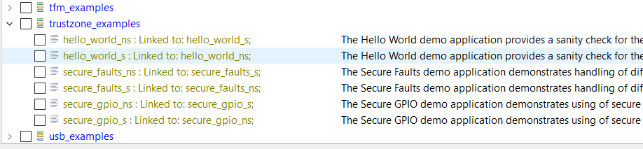

And there are TrustZone demo based on LPC55s69 under MCUXpresso SDK:
Download SDK from:
https://mcuxpresso.nxp.com/en/select
