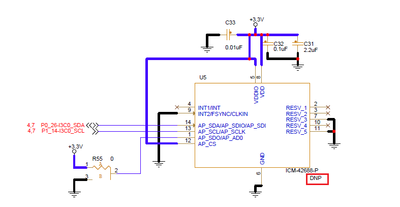

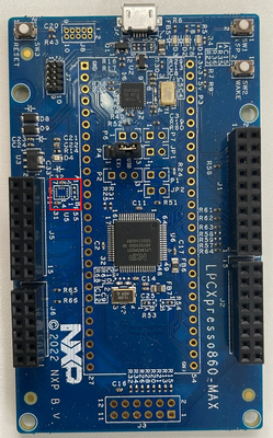

If you use the LCPXpresso860MAX board,
There is no ICM-42688-P (DNP)on the board.
The schematic shows  ICM-42688-P as DNP.
So I3C demo for ICM-42688 not working on LCPXpresso860MAX.
Hope this will help you.

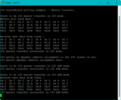

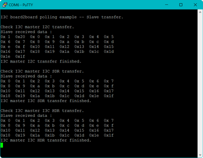

5,911 Views
tinmancp
It doesn't appear to be a hardware issue.  Running the i3c_polling_b2b_transfer_master and i3c_polling_b2b_transfer_slave, the output to the terminals show the I3C is working as expected.
