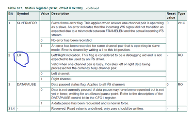

xiangjun_rong
Hi.
I think it is complicated why the left/right channels are swapped, for example, the FIFO overflowing or under-flowing all can lead to the channel swap. you can set the PAUSEDATA bit in CFG1 register, then poll the PAUSEDATA bit in status register, then clear the PAUSEDATA bit in CFG1 register to correct the swap.
Hope it can help you
XiangJun Rong
3,841 Views
xiangjun_rong
For LPC552x, you use the I2S in master mode, both the left and right channels use the same FIFO FIFOWR, so you can not identify or control which channel you will write.
There is a flag in I2S status register, which can reflect the current channel, but the flag is only used in debugger instead of driver.
