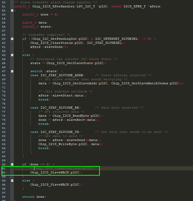

I have tried call Chip_I2CS_SlaveNACK() after a SlaveAddress or DataByte received, but it sames that the state machine of the I2C slave have stopped and cannot continue to monitor data from I2C Bus.

    The Chip_I2CS_SlaveNACK() function from lpcopen_3_02_lpcxpresso_nxp_lpcxpresso_812.zip
     lpcxpresso812\chip_81x\src\i2cs_8xx.c

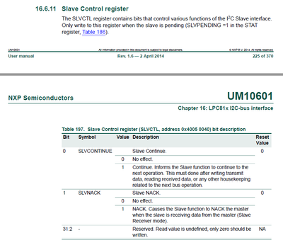

As the LPC81x User manual, since SLVCONTINUE means "Informs the Slave function to continue to the next operation", SLVNACK means "stop to the next operation'?

Based on I2C protocol, I think that SLVNACK means "stop to the next operation"
