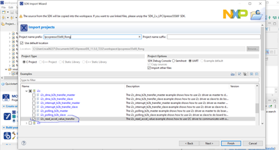

You can refer to the example code like:
Because I use the example based on LPC55S69-EVK, I do not know if there is similar example based on LPC5512-EVK.
