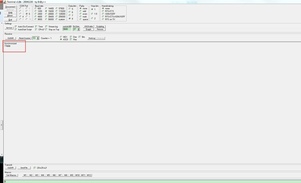

I'd like to replicate your issue by using the below code at first, as the result, the code works well (Seeing Fig 1) and it's compliant with Boot process section in the UM.
/* Reinvoke ISP */
uint8_t Chip_IAP_ReinvokeISP(void)
     uint32_t command[5], result[5];
     command[0] = IAP_REINVOKE_ISP_CMD;
     iap_entry(command, result);
     return result[0];
                                                                   Fig 1
Hope this is clear
Ping

timothymasters
Hi Ping,
Your reply was not helpful. You did not reply to my invocation code example. I have tried the code and it does not work.
For your information, Flash Magic does not work with a binary file. It must be an intel hex file. So apparently the LCPXpress does not have a utility to generate an Intel hex file of the executable. I was able to find a translator program to do this successfully.
Now I need help in understanding why my Reinvoke() function does not work. Here is the code:
Reinvoke ISP Invocation from Application
//here is my code//
#define IAP_LOCATION 0x1FFF1FF1
uint16_t command, status_result;
uint16_t *command_parameter, *command_result;
command = 0x57; //command to Reinvoke_ISP
command_parameter = &command;
iap_entry = IAP_LOCATION;
iap_entry(command_parameter, command_result);
The above code compiles successfully but the application does not seem to transfer control to the ISP function. Instead, the application seems to run as if it is ignored. Here are some follow up questions:
1. I am running the program through the debugger. Could this be the problem?
2. I am using unsigned 16 bit variables. Should they be 32 bit?
3. If you can not help me with this problem can you escalate this to some one more familiar with this issue. I need to ship to my customer by Jan. 27.
Thanks for your help.
Tim
