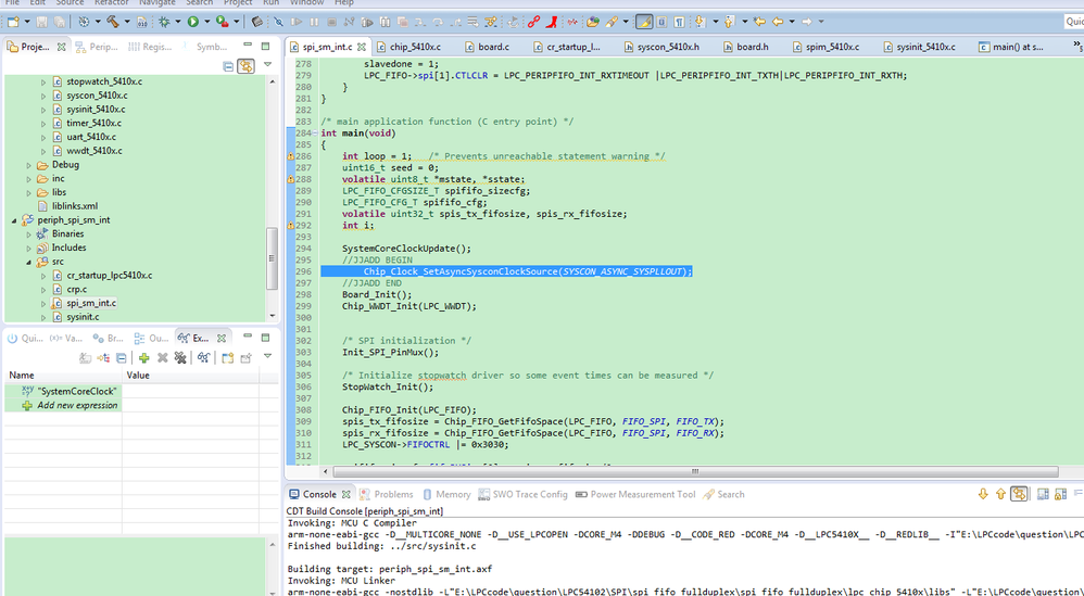

    I already help you to modify the lpcopen code:periph_spi_sm_int, it now can work with 21Mhz, using the SPI FIFO.
   The main problem of lpcopen can't reach higher than 12Mhz is:
1. The system clock should configure higher, if you just use 12Mhz,  of couse, it can't reach higher than 12Mhz.
So, you can use PLL to get 96MHZ.
 Modify points, in the board.h,
#define BOARD_MAINCLOCKRATE     (96000000)
If you use different board, both master and slave SPI board should configure the system clock to 96MHZ.
2. Configure the SPI modoule clock base, the async APB clock should also higher than 12Mhz.
The lpcopen just use 12Mhz as the SPI source, so you can't generate higher than 12MH baudrate.
Please add this code in the main:
        Chip_Clock_SetAsyncSysconClockSource(SYSCON_ASYNC_SYSPLLOUT);

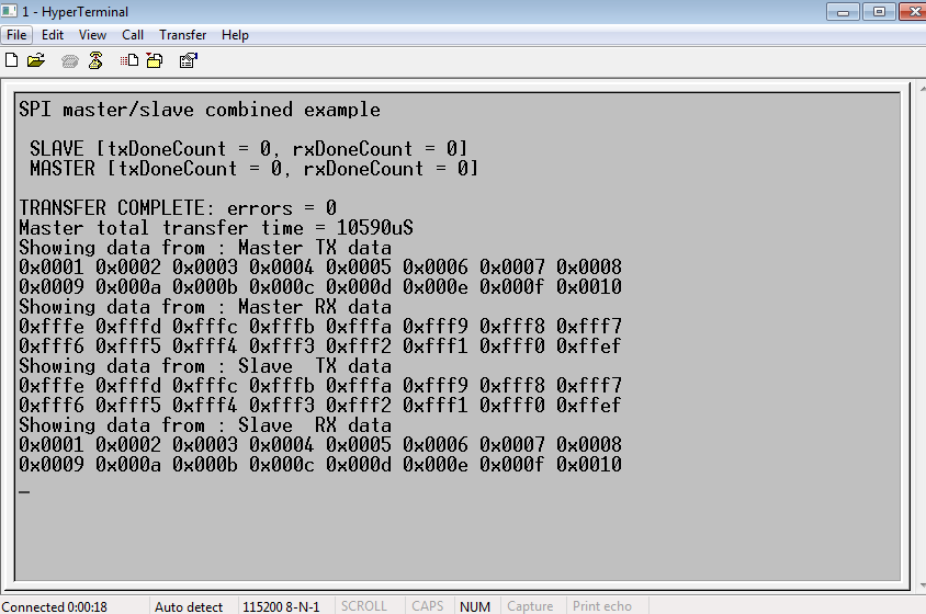

Then build and test it in the lpcxpresso LPC54102 board, I can get 21Mhz SPI, and the data is correct, this is the test result and the SPI wave.

With regards to the screenshot you sent I can see that On Master Rx you have not received the data same is what sent on Slave Tx.
I am asking this because I am facing similar problem. From master to slave the data goes fine at 21 MHz. But from slave to master the data is not received correctly.

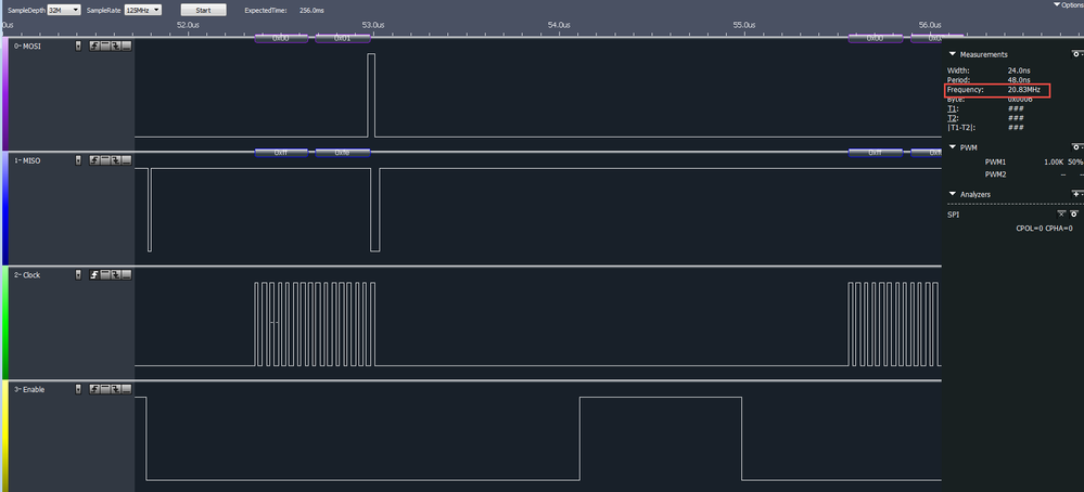

kerryzhou
Hi Tarun Chaplot,

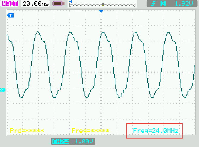

   I got the root problem why the master can't receive the correct data from slave in 21MHZ.
  It's still the clock problem, the logic analyzer tool sampling rate is not enough, the clock rate is measured wrong.
  I check it with the oscilloscope again, the defined 21Mhz baud rate, actually , the output spi clock is 24Mhz.

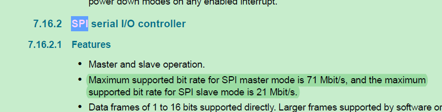

As you know, the LPC54102, the maximum supported bit rate for SPI slave mode is 21Mbit/s.

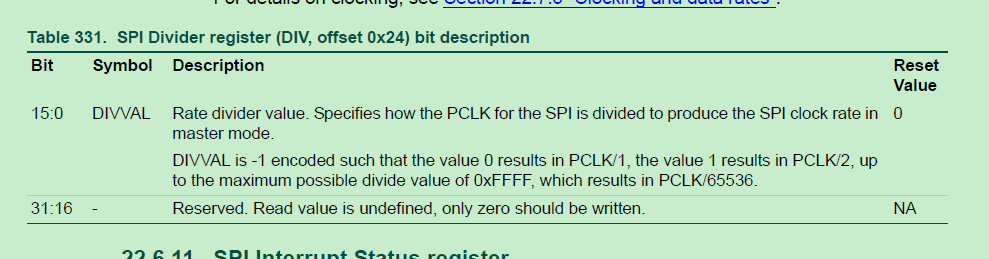

But the core clock is 96Mhz, if you debug the code, you will find the SPI divier register is 3, the divider is 4.
Divider 4 will cause the SPI clock rate to : 96M/4=24Mhz.
So, it already exceed the maximum supported bit rate for SPI slave mode.
Then the core is 96Mhz, and it is the source for SPI module, then the slave spi max bit rate is : 96MHz/5=19.2Mhz.

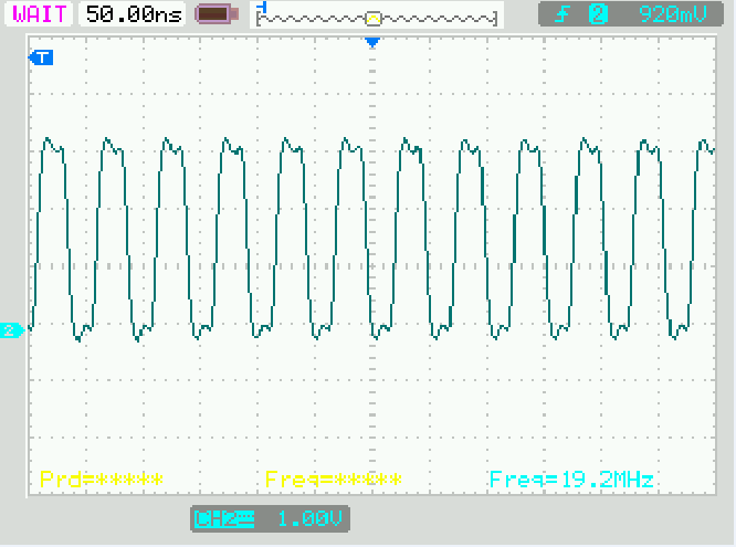

So, I configure code:
#define LPCMASTERCLOCKRATE                 19000000
It will set the divider register to 4(divider is 4+1=5), the debug data is:
Then I check the clock rate in the oscilloscope, it is 19.2Mhz, just as defined.

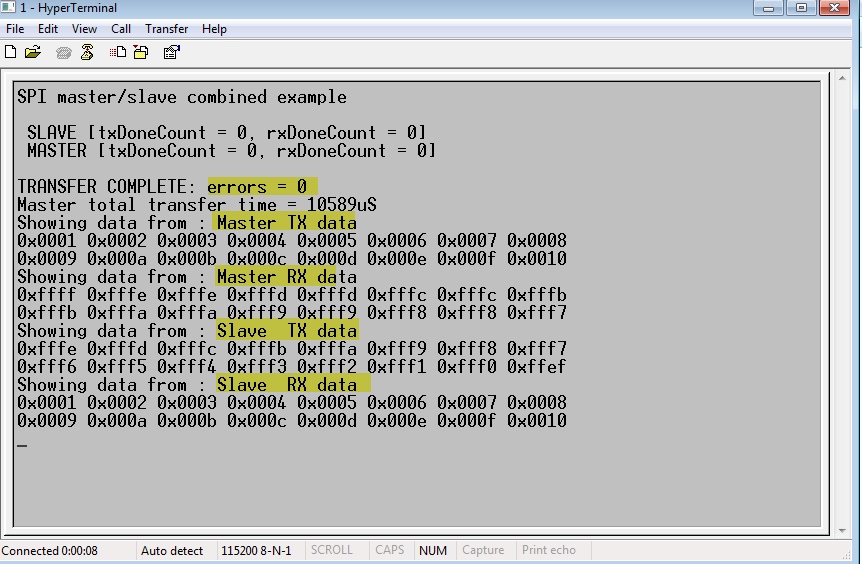

The terminal data is:
You can find, if the master clock is in the range of the slave maximum clock, the transfer data is correct.
If you meet the similar problem in the DMA SPI mode, so, please check your clock configuration like me. use the oscilloscope to check the spi rate, whether it is correct.

    According to the datasheet, the maximum supported bit rate for SPI salve mode is 21Mbit/s LPC54102 .
  So, 12Mhz must can work from the hardware side.
