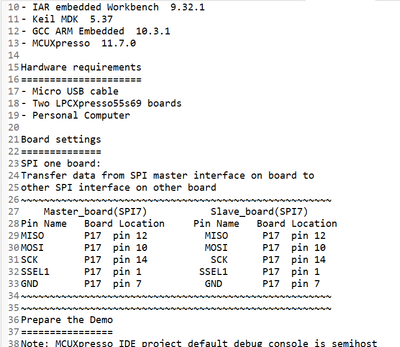

Hello @sushmasan
Yes, you can. Just follow the readme under SDK example to connect hardware and run code.
For example SPI_interrupt demo. Hardware connection as below:
Alice

Hi @Alice_Yang ,
Thank you so much. It is really helpful. I didn't realize that there is a readme file. After checking the directory structure, I saw there is a doc folder which contained the readme file.

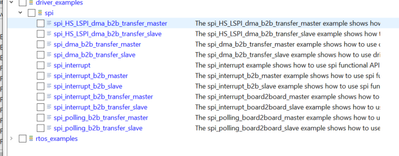

Hello @sushmasan
What's your other board? For LPC55s69 side, there is SPI master/slave demo under SDK. You can use it. Download SDK from: https://mcuxpresso.nxp.com/en/select
