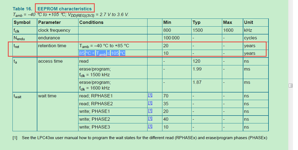

I need to know the retention time of the EEPROM. I can find only the number of write/erase cycle (>100k) but no info regarding the retention time.

   The retention time of EEPROM inside the LPC43S37JET100 is:
1. Tamb = -40 degree C to +85 degree C, the retention time is at least 20 years.
2. 85 degree C < Tamb <=105 degree C, the retention time is at least 10 years.
Actually, you can find this information in the LPC43S37JET100 datasheet:
http://www.nxp.com/documents/data_sheet/LPC43S5X_S3X.pdf
page 107,
Wish it helps you!
If you still have question, please let me know!
Kerry
