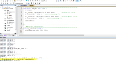

Also, there is a problem with the Run-Time Environment settings of this example project file.
NXP::Device:Startup software components requied NXP::Device:CMSIS:LPC55S69_system.
However, The NXP::Device:CMSIS:LPC55S69_system are not selected.
This issue can be easily fixed from the "Manage Run-Time Environment".
All you have to do is click the resolve button and OK button.
However, even with this fix, the rebuild does not succeed.
The following is the error message when rebuilding.
Build Output:
startup_LPC55S69_cm33_core0.S: Error: A1067E: Output file specified as 'C:\Users\USER_NAME\AppData\Local\Arm\Packs\NXP\LPC55S69_DFP\12.4.0\arm\startup_LPC55S69_cm33_core0.S', but it has already been specified as '.\objects\startup_lpc55s69_cm33_core0.o'
startup_LPC55S69_cm33_core0.S: error: A1023E: File "assembler-with-cpp" could not be opened: No such file or directory

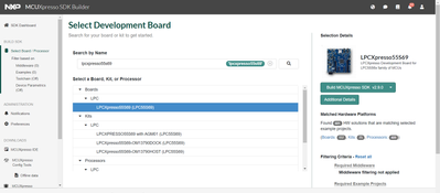

There is demo for LPCXpresso55s69 under MCUXpresso SDK, it support KEIL, just download and
open to build:
https://mcuxpresso.nxp.com/en/select

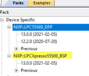

Hello, I test it on my side, it work well
It seems you missing a BSP for LPCxpresso55s69 board:
