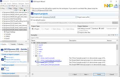

I suggest you refer to the _ctimer_match_interrupt_example, the CTimer generate programmable period interrupt, in the ISR, you can switch the task.
You can use the systick module to generate interrupt, the systick module is core module, it's interrupt is of higher priority. For the systick module, you can refer to the led_blinky_example as the following Fig.
For the CTimer clock selection, I think you can use the line for 1MHz free running clock.
CLOCK_AttachClk(kFRO1M_to_CTIMER2);
