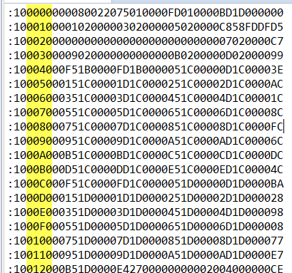

Hi Ramesh,
There is address information in Hex file,for example the below hex file, the highlight part is address.
You should refer to your hex file to flash.
BTW, you use USB update firmware, which memory you put the USB related code ?
