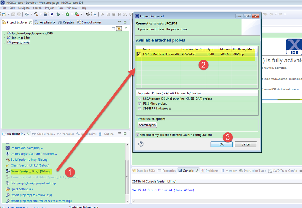

3. You can click debug button like the following picture, it will search automatically.
Then choose the multilink and OK, it will enter in the debug mode.
Wish it helps you!
