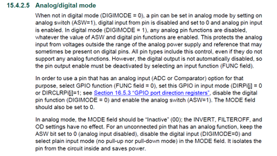

Hello, all
I am trying to use the headers on my board (J13) to take in analog input; however, it appears that the GPIO pins are only for digital input/output. In the MCUXpresso SDK API Reference Manual, the only accessible GPIO "pin directions" are kGPIO_DigitalInput and kGPIO_DigitalOutput.
I want to setup a pin as an analog input, but do I accomplish this by using the GPIO method? If not, do I have to use the ADC instead?
Thanks in advance.
1 返信
2,247件の閲覧回数
Hello caden013,
What function do you want to use about the analog signal?
Only the below pins can used as analog function:
And please pay attention the configuration:
Alice
