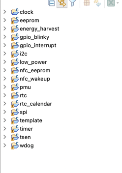

DannyGembom
This is the list of app that exists on the board
As you can see the is no "demo app" mentioned in the video. I want the same demo app that exist on the board when I bought it.
