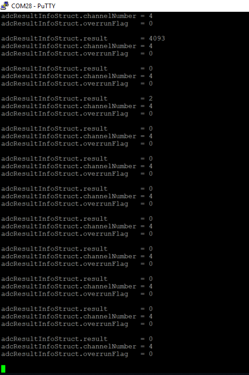

xiangjun_rong
Hi, Prasanna,
I have used ADC channel 4(J12_2 on LPCXpresso54808 board, PIO0_16/ADC0_IN4) to test the external voltage, when I connect the J12_2 to 3.3V, the sample is from 4091~4093 as the following Fig.
when I connect the J12_2 to GND, the sample is all 0 as the following Fig.
In conclusion, the ADC has not issue.
Xiangjun Rong
Test GND results:

prasannanaik
Hi xiangjunrong‌,
Were you able to simulate the issue in evaluation board of lpc54608.
Also, please check the operation of adc with core clock raised to 100MHz through PLL.
Thanks & best regards,
Prasanna
