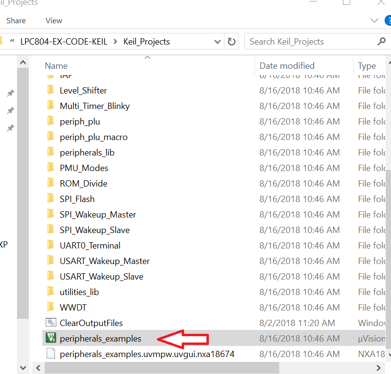

Unzip the file and double click to peripheral_examples under the LPC804-EX-CODE-KEIL\Keil_Projects folder
It is important to build the projects utilities_lib and peripherals_lib before any other example project.

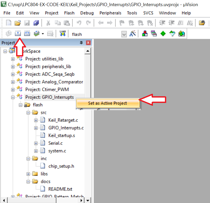

Build the desired example project, in this case GPIO_interrupts
Load the code to flash memory

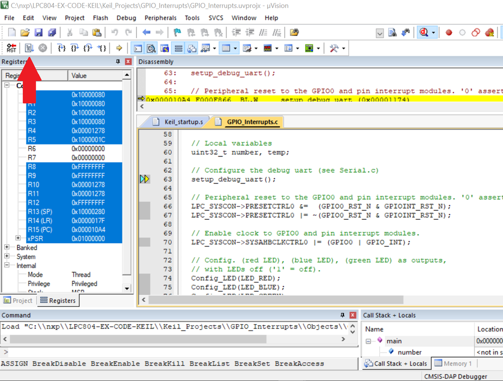

Debug the project
Run the project:

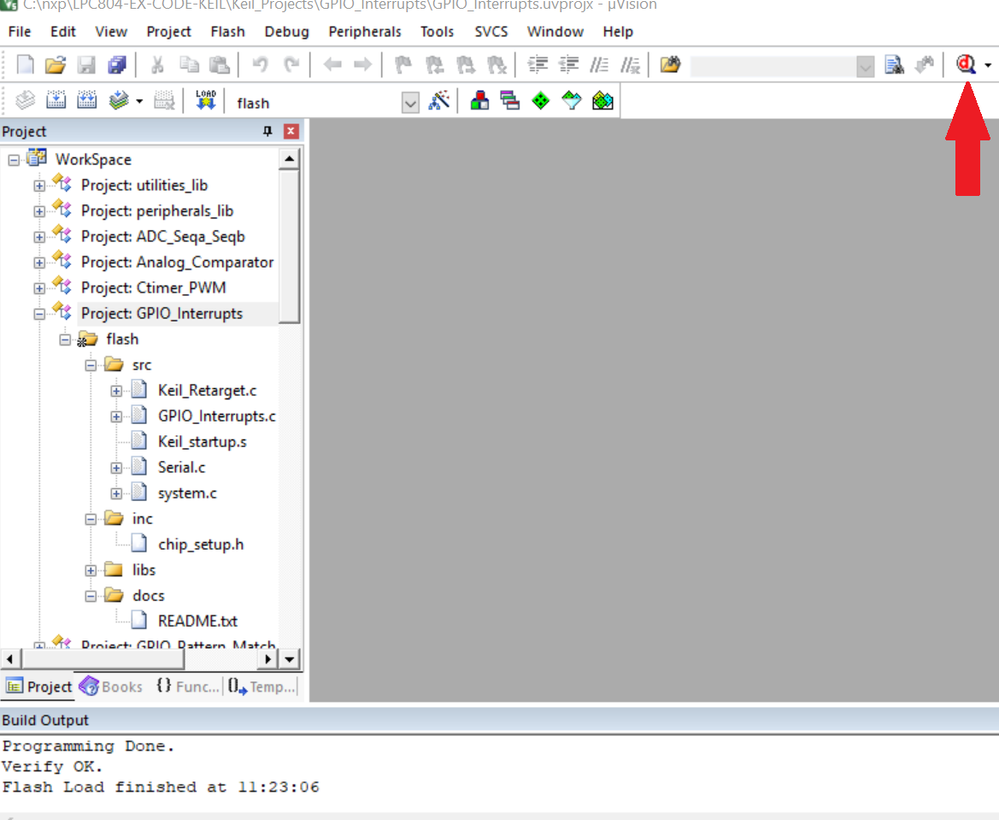

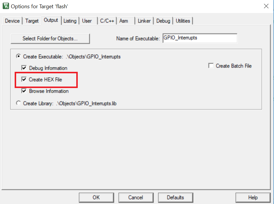

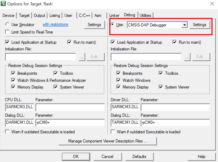

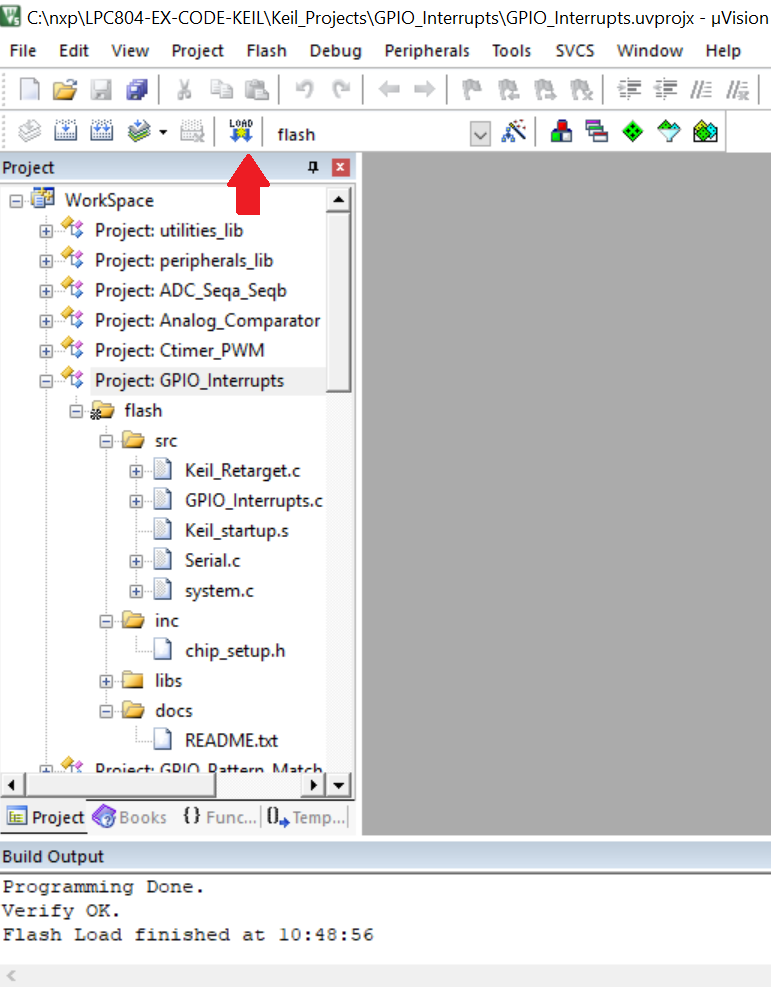

Please check the below options in "Options for target.."

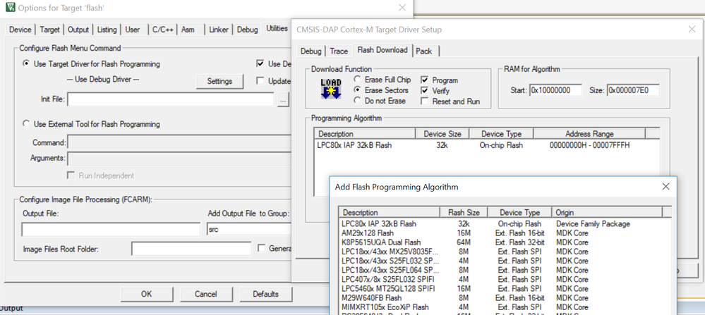

g40
Hi Sol,

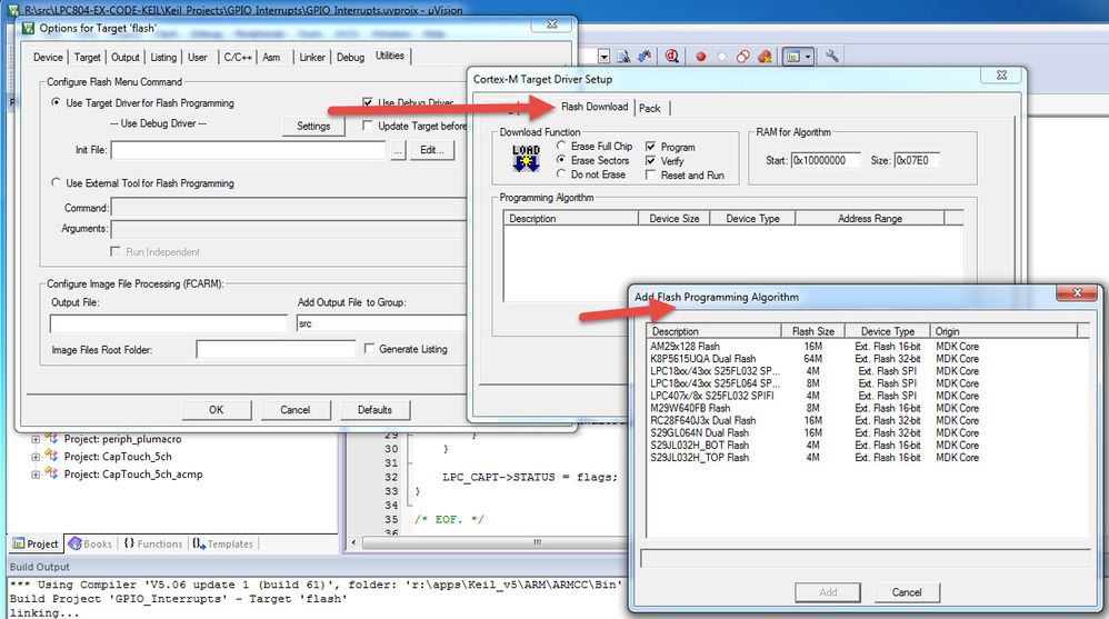

Thanks for the detailed walk-thru, most helpful and it should be in the documentation :smileyhappy:. However, I'm good with all of that. What I'd be really keen to see are the settings you have in the 'utilties' tab, especially for the flash settings. When I try and debug the GPIO interrupts project I get this in the command window:
Build Project 'GPIO_Interrupts' - Target 'flash'
linking...
Program Size: Code=4464 RO-data=536 RW-data=28 ZI-data=612
".\Objects\GPIO_Interrupts.axf" - 0 Error(s), 0 Warning(s).
Build Time Elapsed: 00:00:00
Load "R:\\src\\LPC804-EX-CODE-KEIL\\Keil_Projects\\GPIO_Interrupts\\Objects\\GPIO_Interrupts.axf"
Erase Failed!
Error: Flash Download failed - "Cortex-M0+"
Flash Load finished at 18:13:52
and this is what I get when I navigate via the 'Options for target Flash button and move on to the the utilities tab. The problem is there is no obvious candidate for flashing. I have got the latest NXP pack installed via this link: http://www.keil.com/dd2/nxp/lpc804/#/third-party-download-dialog
Thanks for listening. Much appreciated.

soledad
 You need to add the pack, please check the below link:
Pack Installer
Sol

g40
Hello Sol
So that pack does not install correctly. It looks like it has some malformed content. The 'svdconv.exe' error log is here: https://pastebin.com/UNcxiw3U.
It would be _very_ helpful if you could show your flash utility settings BTW.
