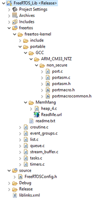

Hello Team,
I am wondering why FreeRTOS build is failing only in Release configuration, where as the build is successful with Debug configuration.
The same code worked fine in both Debug and release configuration with "MCUXpresso IDE v11.10.0_3148"
Any idea, what is different in the new IDE release compared to the last release?
Please find the FreeRTOS directory structure,
Here is the error,
make -r -j16 all
make[1]: *** No rule to make target '../freertos/freertos-kernel/portable/GCC/ARM_CM33_NTZ/non_secure/portasm.c', needed by 'freertos/freertos-kernel/portable/GCC/ARM_CM33_NTZ/non_secure/portasm.o'.  Stop.

HI @sushmasan
Base on the error, No rule to make target '../freertos/freertos-kernel/portable/GCC/ARM_CM33_NTZ/non_secure/portasm.c', needed by 'freertos/freertos-kernel/portable/GCC/ARM_CM33_NTZ/non_secure/portasm.o'.
The file may be missing or the path is incorrectly specified in the build configuration for the Release build.

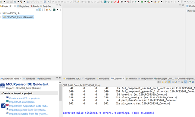

sushmasan
Hi @Harry_Zhang ,
Were you able to build FreeRTOS in Release configuration using IDE version v24.9.25?
Because in your snapshot I saw LPC55s69_Core component build details.
The issue I am seeing is only with FreeRTOS component, that too in Release configuration.
San
