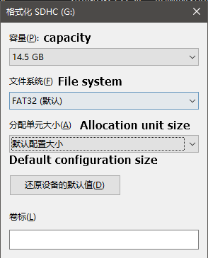

I'm having this issue too.My solution is:
formatted my sdcard ,File system set as FAT32,Allocation unit size set as default,and it is well。
