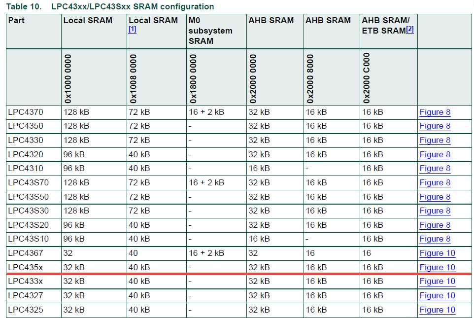

As we mentioned earlier, both Stack are using USB RAM address 0x2000 0000. In the USB host driver USBRAM_SECTION is at
0x2000 0000.
For the Rom driver,  USB_STACK_MEM_BASE      is at 0x2000 0000. For USB0 ENDPOINTLISTADDR is set at 0x2000 0000. I guess we shouldn’t change that?
How to resolve this? Which one should we change?

I agree with you that RAM overlap may be the cause.
Fig 1
The LPC4357 has several parts of RAMs, I'd like to suggest that you can assign two parts of RAM to the USB1 and USB0 respectively.
For instance, the 0x2000_0000~0x2000_2000 is assigned for ROM USB stack.
/* On LPC18xx/43xx the USB controller requires endpoint queue heads to start on
   a 4KB aligned memory. Hence the mem_base value passed to USB stack init should
   be 4KB aligned. The following manifest constants are used to define this memory.
#define USB_STACK_MEM_BASE      0x20000000
#define USB_STACK_MEM_SIZE      0x00002000
Meanwhile, USB1 stack is located in AHB SRAM section (0x20008000~0x200C0000), thus they're independent with each other.
Please give a try.

However Host Mass storage needs around 0x5088 bytes (according to our map
file) and at the address you mentioned there are only 0x4000 bytes. Anyway
I did try to build and linker fails as expected and gives the following
message.
unable to allocate space for sections/blocks with a total
estimated minimum size of 0x4688 bytes (max align 0x1000) in
<[0x2000'8000-0x2000'bfff]> (total uncommitted space 0x4000).
Can we allocate that space to USB1 (ROM Stack) How much space does ROM
stack need?

It's okay to allocate the 0x20000000~0x20008000 to the USB1 and 0x20008000~0x2000C000 to the USB0, as the ROM stack would need 0x2000 bytes space.

Further debugging indicates that two stacks are using USB RAM and that causes the problem.
(we are not 100% sure why the interrupt keeps occurring, but first enumeration process fails due to insufficient memory) In the NXPUSBlib - Pipe_ConfigurePipe function USB_Memory_Alloc is not able to allocate the buffer for Pipe_info.buffer, so the enumeration process fails. Now the question is when we are invoking two stacks, how do we allocate separate USB memory space. Is it as simple as setting two separate base address for two different stacks?
