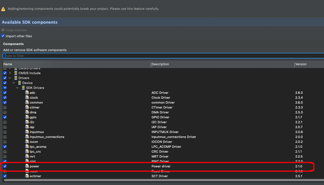

When I try to enable the ADC peripheral using the Configurator tool, I get this error:
Issue: The fsl_power driver is missing in the project .
Level: Error
Type: Validation
Tool: Toolchain/IDE project
Origin: Peripherals:BOARD_InitPeripherals
Target: Toolchain/IDE project: core0
Resource: platform.drivers.power_no_lib
If I try to right-click and select "Add SDK component", I get another error saying that power_no_lib can't be found.
I've tried in a new project on a fresh install of the latest IDE and SDK. No dice!
I do have the power driver installed, so I'm at a loss as to what's going on. Can any of you shed some light on this?

It looks to me like the power_no_lib driver was renamed POWER at some point but the change wasn't carried all the way through in the setup of the SDK and IDE. I use the Mac version (Apple/ARM silicon) of the IDE.
Both SDK and IDE were the latest version (25.6.136). Here's how to reproduce the issue:
- Install the latest IDE and SDK.
- Create a project for the LPC845. I use the 33-pin version, but I doubt that matters. Enable the drivers for the ADC and Power along with the drivers enabled by default.
- Add the ADC in the Peripheral Configurator tool.
You'll notice that there's an error about the power_no_lib.
The only workaround I found was to install an older version of the IDE and SDK. I found other interesting errors that way too. Including:
- The Clocks Configurator tool in the newer IDEs requires the Power driver to be present. But the older SDKs do not have a Power driver. They have power_no_lib instead. So while it is possible to enable the ADC on IDE v. 25.06 with SDK v. 2.14, you can't configure the clocks.
I ended up installing IDE version 11.9.1 and SDK version 2.14 to make it work. That was the newest combination of IDE and SDK that I could find that would allow me to both configure the clocks and the ADC.

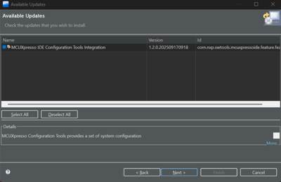

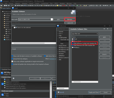

The problem is resolved in MCUXpresso Config Tools 25.09. In the existing MCUXpresso IDE, it is possible to update the version of Config Tool by following steps:
  1. Enable MCUXpresso Config Tools update site in Help > Install New Software > Manage > MCUXpresso Config Tools Update Site – make sure it’s checked. Use Apply and Close and exit the Install window
2. Run Help > Check for Updates and install the new Config Tools version

Tried that. Now I can add the ADC driver, but "Driver power" is now missing. The clock configuration tool requires it.
I'll keep using the older version for now.
