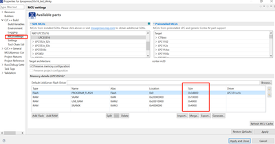

Here is what I am getting.

ZhangJennie
HI SVA-Vending
Please go to project setting to increase RAM size
Please make sure the new defined range is inside the legal RAM memory.
Best Regards
