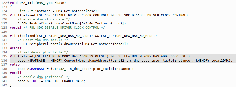

DMA_Init() in fsl_dma.c of SDK 2.7.0 for LPC845BREAKOUT

This is the function:
First action is to get the instance and store it in the variable 'instance'.
Why is this variable not used in line 127 and 132, like it is in line 138?

Hi 1234567890
I´ve found   no special reason. You are right pointing out this,   the variable instance could be used again in those lines since the base won't change.
