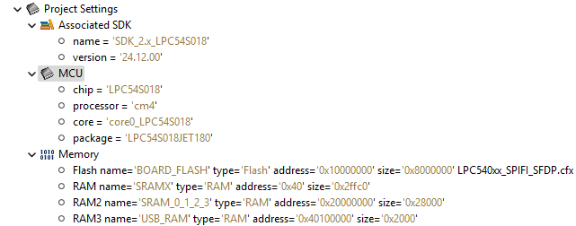

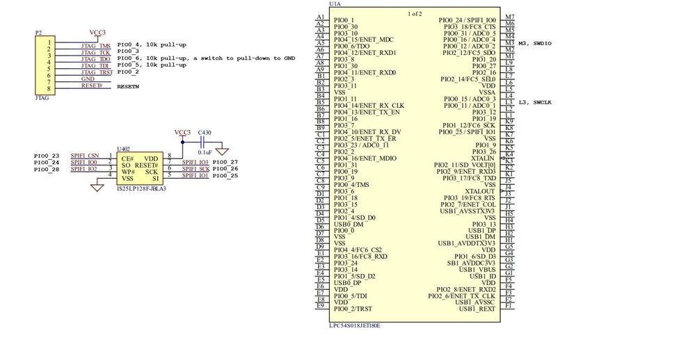

Hi All,
     I am trying to import a "lpcxpresso54s018_hello_world_qspi_xip" to my custom board. But I got an error message "File 'lpcxpresso54s018_hello_world_qspi_xip_HelloWorldSPIFI004.bin' load failure: Ef(11). No flash configured at the specified address." . The goal is to upload an image to the EXT SPI FLASH and the MCU will boot from the EXT SPI FLASH.
     Can anyone please give an advice on how to fix the issue?

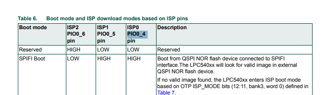

Hi @mtsang
I got some new idea from our internal team.
You can check the ISP pins, to ensure that the chip boot type is SPIFI flash boot.
And they suggest to refer to the AN12122 .
You can use lpcxpresso54s018_hello_world_qspi_xip this demo.

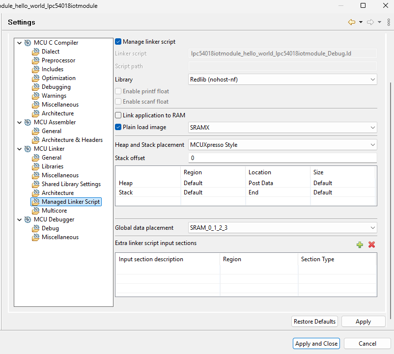

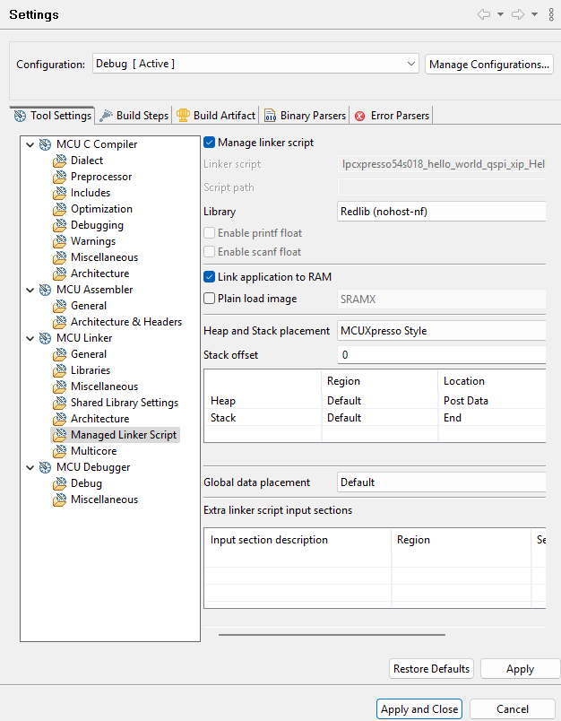

Harry_Zhang
Hi @mtsang
I have a question.
According to your need.

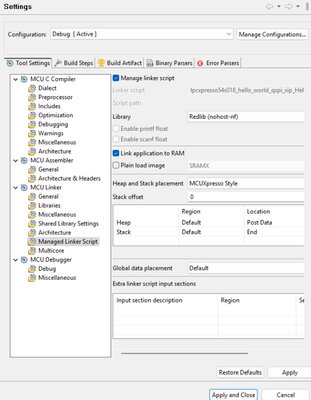

Why you select the "link application to ram"
You can deselect this, and try again.
Harry
2,964 Views
mtsang
Hi Harry,
     I deselect the "Link Application to RAM" and I got the below error message:

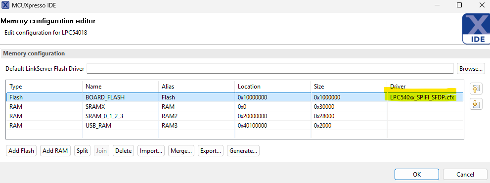

Inspected v.2 External Flash Device on SPI LPC540xx_SPIFI_SFDP.cfx
Image 'LPC540xx_JEDEC_SFDP Dec 18 2024 17:26:01'
Opening flash driver LPC540xx_SPIFI_SFDP.cfx
Using SOFT reset to run the flash driver
rst - Boot ROM stall address was not accessed (but we entered debug on Halt anyway)
Driver V.2 dynamic startup failed - driver Init provided no flash parameters
Flash Driver V.2 startup failed - rc Ef(55): Dynamic flash driver startup failed to provide flash parameters.
Terminate (0x0, 0x0, 0x0) status 0x40 - driver reports init failure - EXTSPI driver rc 15 (0xF)
chip initialization failed - Ef(55): Dynamic flash driver startup failed to provide flash parameters.
failed to initialize flash driver LPC540xx_SPIFI_SFDP.cfx

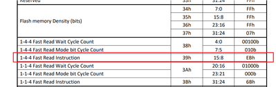

Harry_Zhang
Hi @mtsang
From your log:
The SPIFI  flash driver attempted to probe your external flash device via SFDP, but failed to identify valid parameters for your flash.
What is the exact part number of the flash IC on your custom board?
Check its datasheet for SFDP support — not all parts provide SFDP data.

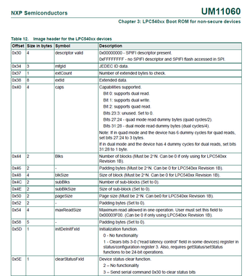

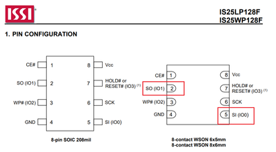

mtsang
Hi Harry,
     Thank you so much for the reply!

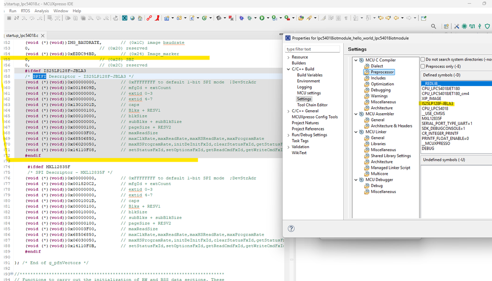

     I am using "IS25LP128F-JBLA3" for the custom board. According to the datasheet(please see attached IS25LP128F-JBLA3 datasheet), it seems to support SFDP. I am switching back to "LPC540xx_SPIFI_SFDP.cfx" for memory config.
   I checked the "SPIFI Descriptor"  in the "LPC54S018JET180E lpcxpresso54s018_hello_world_qspi_xip" startup_lpc54018.c
I saw the SPIFI Descriptor :
#ifdef W25Q128JVFM
/* SPIFI Descriptor - W25Q128JVFM */
(void (*)(void))0x00000000, // 0xFFFFFFFF to default 1-bit SPI mode ;DevStrAdr
(void (*)(void))0x001870EF, // mfgId + extCount
(void (*)(void))0x00000000, // extid 0-3
(void (*)(void))0x00000000, // extid 4-7
(void (*)(void))0x0001001D, // caps
(void (*)(void))0x00000100, // Blks + RESV1
(void (*)(void))0x00010000, // blkSize
(void (*)(void))0x00000000, // subBlks + subBlkSize
(void (*)(void))0x00000100, // pageSize + RESV2
(void (*)(void))0x00003F00, // maxReadSize

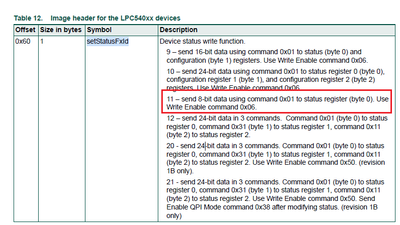

(void (*)(void))0x68506850, // maxClkRate,maxReadRate,maxHSReadRate,maxProgramRate
(void (*)(void))0x04030050, // maxHSProgramRate,initDeInitFxId,clearStatusFxId,getStatusFxId,
(void (*)(void))0x14110D09, // setStatusFxId,setOptionsFxId,getReadCmdFxId,getWriteCmdFxId
#endif

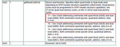

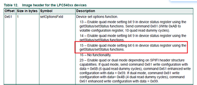

     Should I change the SPIFI Descriptor(I modified the Bold Text)? Also I am unsure what to change for the under-line section. What else I need to change in order to make the example project works on my custom board:
#ifdef IS25LP128F-JBLA3
/* SPIFI Descriptor - IS25LP128F-JBLA3 */
#endif

Harry_Zhang
Hi @mtsang
You are right. You need to modify the SPIFI Descriptor.
You currently have:
This corresponds to:
mfgId = 0xEF (Winbond, not correct for IS25LP128F)
device ID = 0x70 (part of JEDEC ID for W25Q128)
But for IS25LP128F, the JEDEC ID is:
Manufacturer ID = 0x9D (ISSI)
Memory type = 0x60
Capacity = 0x18
So you should change:
(void (*)(void))0x0018609D, // mfgId + extCount (extCount = 1, mfgId = 0x9D, memType = 0x60, capacity = 0x18)
And you should also verify

mtsang
Hi Harry,
     Sorry for the late reply and thanks for the infos.
     I am still confused about how to find the info marked with BOLD Text. Can you please provide advice on how to find those infos in the IS25LP128F datasheet.
     Also for the macro marked with BOLD text. Once I changed the macro, is there anything I need to change to the entire project setup like (Project Setting, 'startup_lpc54018.c', etc)
What I found so far, please double check if I am correct
//maxClkRate,maxReadRate,maxHSReadRate,maxProgramRate
Clock Frequency except for fast read: 166Mhz (A3h)
Clock Frequency for read (03h): 80Mhz (50h)
#endif

Hi @mtsang
About the different register define.
I think you can refer to the UM11060 Table 12. Image header for the LPC540xx devices.
I checked the IS25LP128F-JBLA3 DATA SHEET.
Regarding how to configure relevant parameters, let me give an example to illustrate.
1.
So setStatusFxId is 0B.
2.
So setOptionsFxId is 0F
3.
So the getReadCmdFxId is 0x11.
4.
So getStatusFxId is 06.
And so on.
And i write one based on the  IS25LP128F-JBLA3 data sheet and the  SDK startup_lpc54s018.c

Hi @mtsang

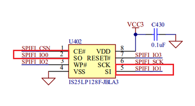

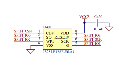

Can you share your schematic about the flash?
Harry
2,762 Views
mtsang
Hi Harry,
     Sure! Attached is the schematics of the SPI NOR FLASH.
SPIFI_CSN -> LPC54S018JET180E_N7
SPIFI_IO0 -> LPC54S018JET180E_M7
SPIFI_IO1 -> LPC54S018JET180E_K8
SPIFI_IO2 -> LPC54S018JET180E_M9
SPIFI_IO3 -> LPC54S018JET180E_L9
SPIFI_SCK -> LPC54S018JET180E_M13
7/7/2025
2,756 Views
Harry_Zhang
Hi @mtsang
I think your schematics of the SPI NOR FLASH is wrong.
In the NOR FLASH Data sheet.
PIN 5 SI should be connected IO0.
PIN 2 SO should be connected IO1.
But in your schematic.
PIN 5 SI is connected IO1.
Harry
2,742 Views
mtsang
Hi Harry,
     Thanks for the schematics correction! However it seems like I am able to flash the .bin file to the SPI NOR Flash, but the MCU is not able to boot from the SPI NOR Flash. I installed and removed PIO0_6 pull-up resistor but it didnt help.

If you want to XIP.
Did you try to change to it in startup_lpc54s018.c?
/* SPI Descriptor - IS25LP128F-JBLA3 */
(void (*)(void))0x00000000, // reserved
(void (*)(void))0x1301001D, // caps

Hi Harry,
     I used the SPIFI descriptor you posted, but still it has the same problem.
