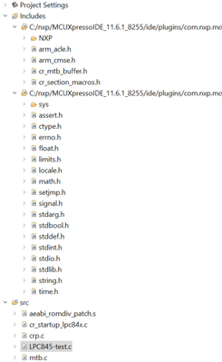

In this way I am able to create a project with the following structure
but I do not see the LPC845.h file that let me access to the register with the CMSIS definitions. Where can I find it?

Hello @topspin
When create new project, you don't have to choose SDK, as below:
