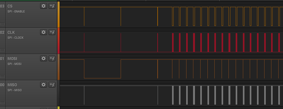

we have a design with a LPC54628. Flexcomm6 is configured for SPI Master and is basically working fine (using DMA transfers). However, when looking at CPOL/CPHA, there is something not quite right. During "normal" SPI read/write (setup of slave device etc) the clock idles low between transfers as it should, but once I start DMA, the clock line idles high. No matter if CPOL bit is set or not, the idle level of the SCLK signal is always high between DMA transfers. I have verified the contents of the CFG register and this is 0x05 (as expected) which is CPHA=0 and CPOL=0. Regardless of this, the clock line idles high between DMA transfers.
Whats going on ?

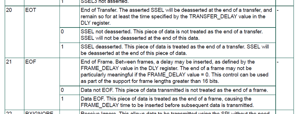

I suppose that you clear the EOT bit in the FIFOWR register when you write the data to FIFO. For detailed information, pls refer to Table 465. FIFO write data register (FIFOWR - offset 0xE20) bit description in UM10912.pdf.
Especially section 26.6.14 FIFO write data register.
I suggest you try to set both EOT and EOF bits and set the TRANSFER_ DELAY in SPI Delay register as  non-zero value, then try to see the CLK logic.

I tried setting:
masterXfer.configFlags = kSPI_FrameDelay | kSPI_FrameAssert;
when I start the DMA transfers, and:
SPI6->DLY=0x1111;
when initializing the SPI port. This seemed to work for a while, however, at some point I no longer get called back by the "DMA done", this happens after approx 4000 to 50000 DMA transfers ! Any idea whats wrong ?

It happens only when the EOT/EOF and DLY are used. The callback (IRQ) that should happen when the DMA finishes, is not coming. As I wrote, this can happen after 4000 DMA transfers or after 50000 transfers. If the EOF/EOT/DLY is not used, the DMA can run for millions and millions of transfers.
How these two things are related I don't (yet) know....
