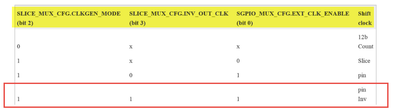

  1. When using the slice mux cfg register, is there a way to invert the external input clock?

Hello @marvincabuenas
1)Try to configure as below:
2) The qualifier can be Disable by setting QUALIFIER_MODE=1, resulting in no shift_clk.
