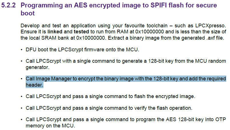

From the LpcScript user guide, it can use AES key to encrypt the iamge file.
However, the --key argument is not supported with current image_manager.exe tool,
I had check the 2.1.0_842 and 2.0.0_831 version of lpcscript.
I search one thread : 'key' argument not supported in this version of image_manager.exe
It seems no one follow up.
I am confused Why not support? Any story or reason?
If no support, why put example in user guide, where can I find the version which support the key argument? If I want to encrypt with my AES key.

You need to submit a case to NXP support in order to get the LPCscrypt with AES enable.
How to submit a new question for NXP Support
