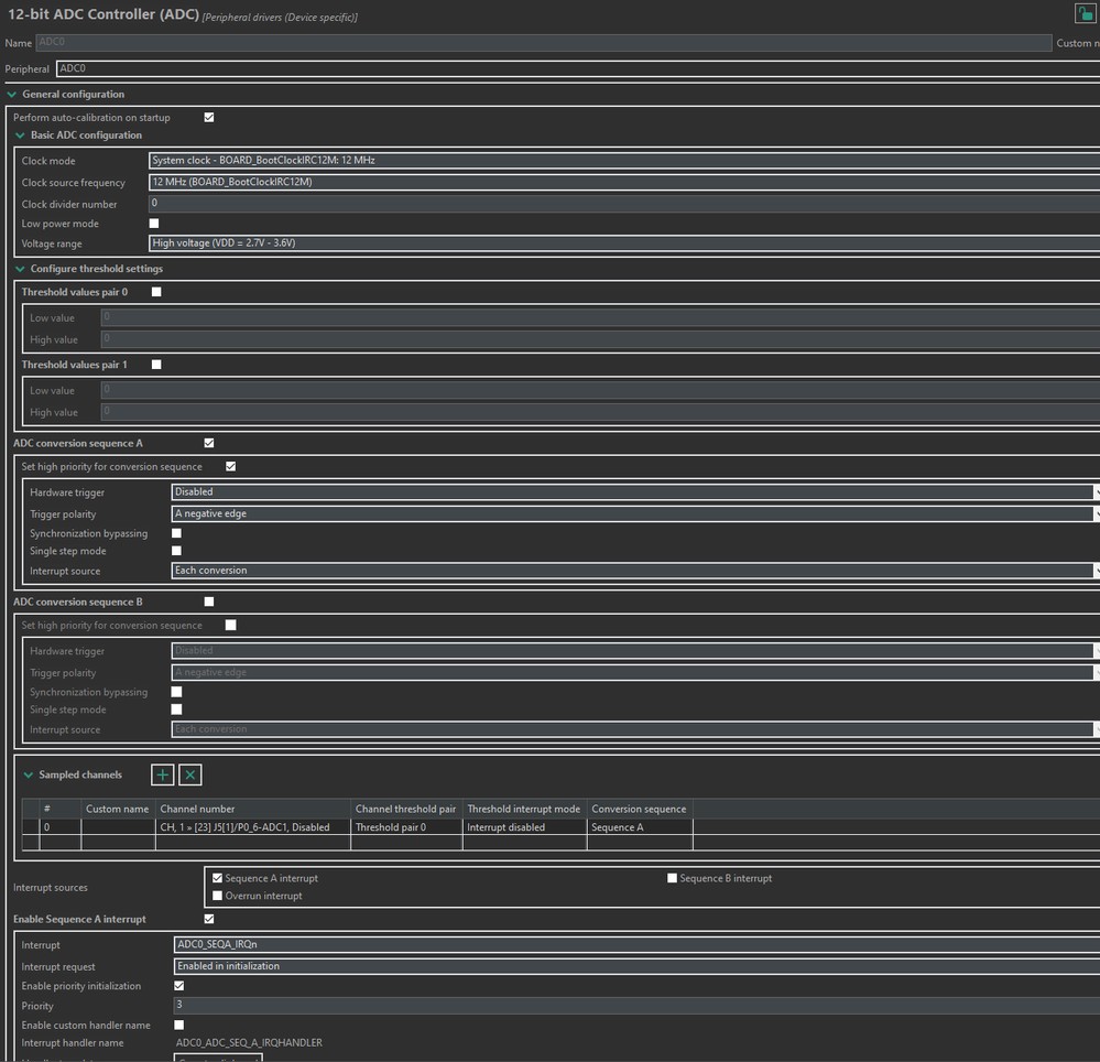

I am trying to continuously sample ADC0 CH1, and have set up using config tools from inside MCUXpresso. When I choose Sampled channels the channel number column always has disabled written at the end.
I suppose rather than continously sample, I would like to use the systemTick to trigger a single channel sample and conversion every 10 ms.
Can you please explain what I am doing wrong in the first paragraph and also how to use the systick to periodically sample instead?

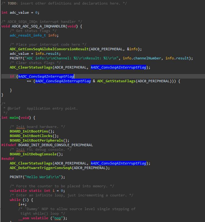

The configTool screen of ADC setupThe configTool screen of ADC setupShowing the code before mainShowing the code before main
For the first paragraph, here is the autogenerated config info (with extra info) from peripherals.c

You can use BURST mode, there is lpc_adc_burst demo under SDK.

Thank you Alice, that is what I wanted. Can you recommend where I would see how to start a conversion from the sysTick handler?
