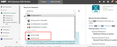

Dear folks,
I am developing application firmware for MCU LPC54113J256BD64.
I was looking to get a project sample from MCUXpresso SDK builder, but the closest that I get is sample project for board development LPC54114 based instead of LPC54113. Can I still use this? Any precaution that I should take?
I don't want to build the project from scratch, any help would be appreciated.
1,729件の閲覧回数
ZhangJennie
Hi misterbee
You can use LPC54114 sample for LPC54113. But you can also get LPC54113 SDK demo directly:
