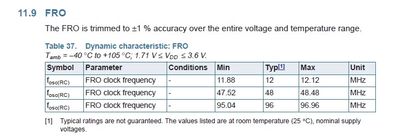

On the LPC546xx devices, we can select between 48MHz and 96MHz FRO (and 12MHz etc).

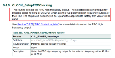

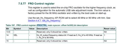

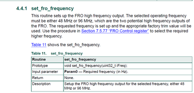

In the datasheet, it is mentioned that "the FRO is trimmed to +/- 1%" but in the Users Manual it is outlined as if it is only the 96 MHz that is factory trimmed. However, when selecting between the 48 and 96 MHz FRO I see that the FROCTRL trim values changes, so I guess that both FRO's are indeed factory trimmed. Can you confirm this ?
The background is we see deviations of up to -4% on the 48 MHz FRO which we use, but so far, only on devices where the PCB has been potted. I wonder if the mechanical "changes" somehow can influence the FRO calibration (if the 48MHz FRO is calibrated from factory)

Hi @carstengroen
"However, when selecting between the 48 and 96 MHz FRO I see that the FROCTRL trim values changes, so I guess that both FRO's are indeed factory trimmed. Can you confirm this ?"
Yes, you are right.
The FRO (12/48/96 MHz) of LPC546xx is factory calibrated (± 1%).
You can refer to these chapters.
"Why you can still measure −4% on some boards?"
Even if the factory has been adjusted by ± 1%,
Environmental factors, especially encapsulation, can still cause significant additional deviations in internal RC/ring oscillators.
