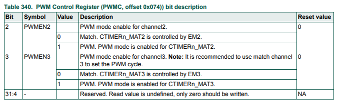

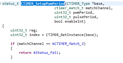

I saw that for the CTIMER2 you're using the MATCH3 register, in the reference manual 17.6.12 in the Table.340 there's
the next note:
And also in the SDK, if you check the CTIMER_SetupPwmPeriod if the MATCH 3 is used the function return fail.
In the OM4006 there's no output pin for the PWM, so if you want to have more PWM, I suggest to check the SCTIMER. There's also an example about it in the SDK.

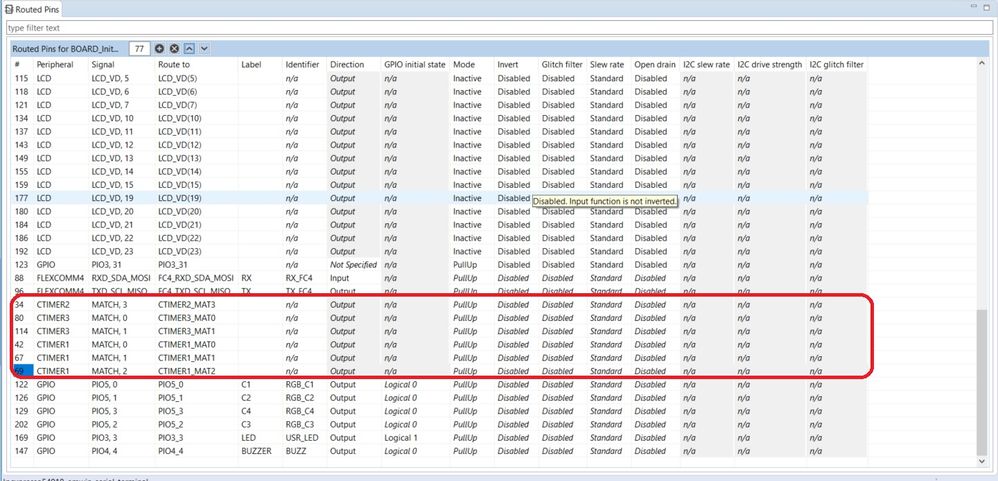

I'm using my own board but I got the OM40006 board too. I need to use 6 or 7 PWM outputs, I have use TIMER 1 Match 0,1,2 and Timer 3 Match 0, 1. Justo Timer 2 doesn't work.
Here how I configured pins:
 and:
the next note:

Hi Alexis Andalon
Thank you so much, I didn't see that part of code,  so I supposse there si no way to use match 3 Chanel on my own board rigth? My interest is because that means we have to do a modification of PCB.
Best Regards
3,640 Views
Alexis_A
That's correct, the CTIMER_MATCH3 is used to store the PWM cycle, so it can't be used a a PWM ouput.
