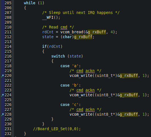

I'm working on a project involving the LPC4370 mcu (LPC link 2 eval board) and Matlab. I need my embedded code to be user-reconfigurable from matlab: the user sends a command, the mcu replies.
I'm using LPCOpen VCOM example as base: it uses USB w/ interrupt.
My C code:
static uint8_t g_rxBuff[256]; [...] while (1) { /* Sleep until next IRQ happens */ __WFI(); /* Read cmd */ rdCnt = vcom_bread(&g_rxBuff, 1); state = (char)g_rxBuff;         if(rdCnt == 1) {             switch (state)             {                case 'a':                  /* cmd ackn */                   vcom_write((uint8_t*)&g_rxBuff, 1);               case 'b':                   /* cmd ackn */                   vcom_write((uint8_t*)&g_rxBuff, 1);                case 'c':                   /* cmd ackn */                   vcom_write((uint8_t*)&g_rxBuff, 1);             }         } }
Here I wait for a command and then I try to echo it back to host (i.e. ackn).
In Matlab
BaudRate=115200; serial_object=0; delete(instrfind('Type','serial')); serialInfo = instrhwinfo('serial'); serial_object=serial('/dev /ttyACM1','BaudRate',BaudRate,'InputBufferSize',4*4096,'OutputBufferSize',4*4096); fopen(serial_object);
sendCmd(serial_object,'a'); sendCmd(serial_object,'b'); sendCmd(serial_object,'c');
Where
function ret = sendCmd(serial_object, cmd_sent)    fwrite(serial_object, cmd_sent, 'char');    cmd_read = fread(serial_object, 1, 'char');    if (~isempty(cmd_read) && (cmd_read == cmd_sent))       disp(strcat('SENT: ', cmd_sent));    else       disp(strcat('ERROR: ', cmd_sent));    end end
So this basically never works. I always get errors like:
Warning: The specified amount of data was not returned within the Timeout period.'serial' unable to read any data. For more information on possible reasons, see Serial Read Warnings.
Since I've been working on this for a while now I can tell that port set-up is ok, I managed to get data out of the mcu with the same configuration.
So I think I'm missing some how-to-basics here. The only assumption I made is that the USB IRQ is triggered everytime Matlab writes to the mcu.

I checked what happens in the MCU using SWD.
Here's the IRQ calls timeline, after I issue this command from Matlab:
 fwrite(serial_object, 'a, 'char');
So a lot of calls are occurring, just for one byte. And you are right, my C code does not enter the swith case.
I.e. these break points are never hit:
Do you have any suggestions given this infos?

a_bet
Hi jeremyzhou‌ sorry for the late reply. I found a bug in the previous code:
Was wrong since I was casting the start address instead of the first value.
Replacing with
state = g_rxBuff[0];
I see some activity, but the system is not behaving in a predictable way.
In Matlab I do this:
    pause(0.5)
    pause(0.5)
But the micro does not reply, or it doubles the otuput. For example if I send 'b' I got 'bb' (or even 'bbb') instead of 'b'.
