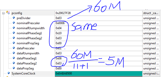

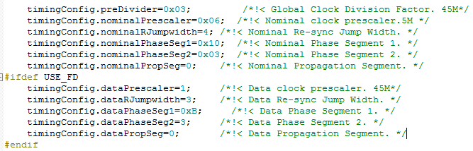

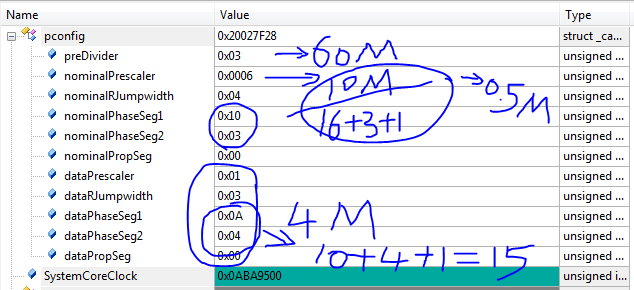

黎明孟
Hi Alexis
i have checke the resgister also,but seems the parameters are right to generater the 5M data bitrate;
The paratermeters auto calculated in
static int CAN_CalculateTimingValues(..........)
and when set to 180M
The 4M data rate;
The 5M data rate:
Then change to manual fill, the 0.5/4M works well;
but can't work with 5M no matter what the groups for the timingConifg setting;
Do you have the decoded data to demonstrate the communication is OK, or can you send your Demo to me for test?
