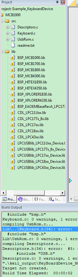

I find that it has some errors after compiling the demo.
The keyboard demo illustrates a board will enumerate on the PC as a HID Keybaord device after connect to a PC when is demo is running
For your implemenation, the board will become the host, and it need to do some modifications, however I don't find these modification in the attachment.
Whether you can introduce them in details.

In fact the master is the microcontroler LPC1769, and the slave is the smartphone .This is the link to retrieve the compile-able demo :
https://www.dropbox.com/s/rjldi5vbcvq5oaw/code%20npx.zip?dl=0
