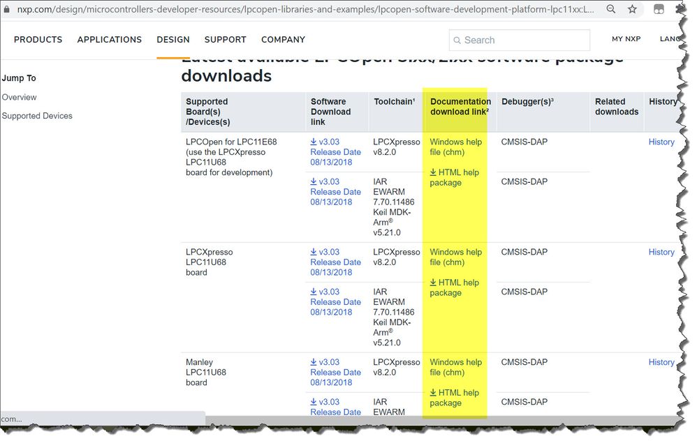

Hi Jun,
thanks for your reply.
I will dig into the demo packages but the problem is that I setup up the chip on a bread board. So I do not have a LPCXpresso board with that chip.
I was not aware to build CHIp and board Library. Is the a documentation available to do that?
Kai
3,111 Views
ZhangJennie
Hi Kawi
There is LPCOpen document on the LPCOpen download site. You can check by yourself if the related information is included.
Anyway, build chip and board file is necessary because the application project need it during build.
Have a nice day,
Jun Zhang
