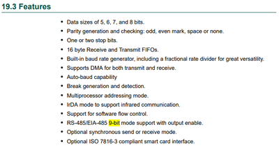

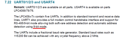

michelle2022
Hi Edwin,
In addition, I found several points that seem to support 9-bit mode in the document.
Is there a work-around method to transmit 9-bit through UART1 ?
Thank you
Michelle

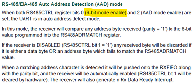

EdwinHz
Hi @michelle2022,
The 9th bit in this case is just for the auto address detection feature, not for transmitting 9-bit data size frames. The explanation of this feature is described on section "17.5.21 RS-485/EIA-485 modes of operation" of the User Guide.
BR,
Edwin.

michelle2022
Hi Edwin,
Thanks for clarifying.
But, I can see the comment of "9-bit enable" in the RS485CTRL register description for AAD mode.
Could you let me know what it means?
Thank you
Michelle
