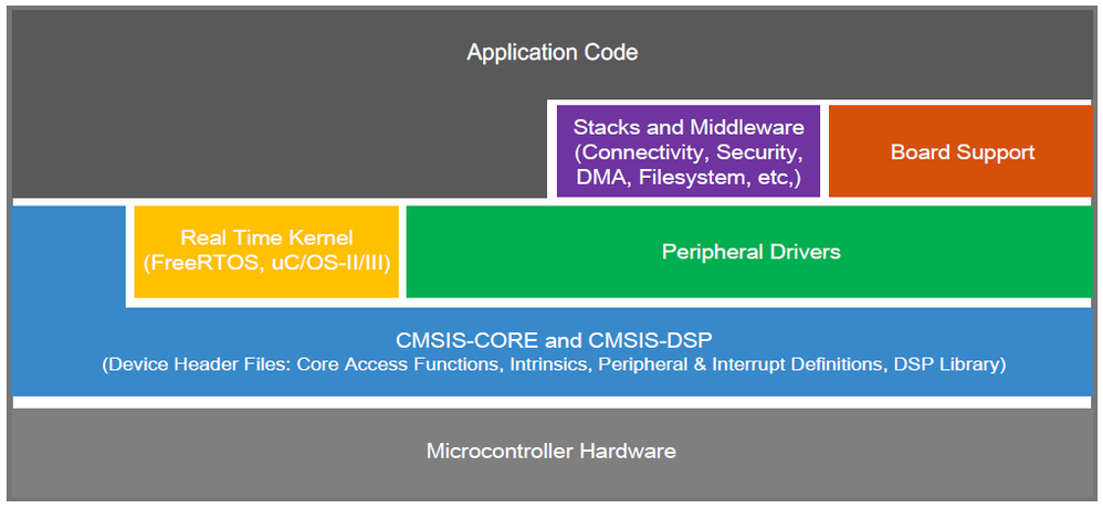

What's New in MCUXpresso SDK v.2 for LPC54xxx?
The Software Development Kit (SDK) 2.0.0 is a collection of software enablement for microcontrollers that includes peripheral drivers, multicore support, and integrated RTOS support for FreeRTOS OS and μC/OS. In addition to the base enablement, the SDK is augmented with demo applications and driver example projects, and API documentation to help the customers quickly leverage the support of the SDK.

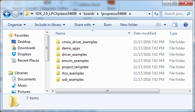

SDK Board Support Folders
SDK board support provides example applications for development and evaluation boards. Board support packages are found inside of the top level boards folder, and each supported board has its own folder (a SDK package can support multiple boards). Within each <board_name> folder there are various sub-folders to classify the type of examples they contain.
demo_apps: Full-featured applications intended to highlight key functionality and use cases of the target MCU. These applications typically use multiple MCU peripherals and may leverage stacks and middleware.
driver_examples: Simple applications intended to concisely illustrate how to use the SDK’s peripheral drivers for a single use case. These applications typically only use a single peripheral, but there are cases where multiple are used (for example, ADC conversion using DMA).
rtos_examples: Basic FreeRTOS examples showcasing the use of various RTOS objects (semaphores, queues, and so on) and interfacing with the SDK’s RTOS drivers
usb_examples: Applications that use the USB host/device/OTG stack.
multicore_examples: Applications for both cores showing the usage of multicore software components and the interaction between cores.

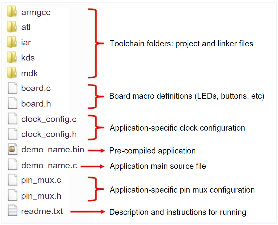

Each <board_name> folder in the boards directory contains a comprehensive set of examples that are relevant to that specific piece of hardware. We’ll discuss the hello_world example (part of the demo_apps folder), but the same general rules apply to any type of example in the <board_name> folder.
In the hello_world application folder you see this:
All files in the application folder are specific to that example, so it’s very easy to copy-paste an existing example to start developing a custom application based on a project provided in the SDK.
