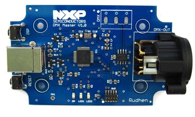

DMX512 Master Board

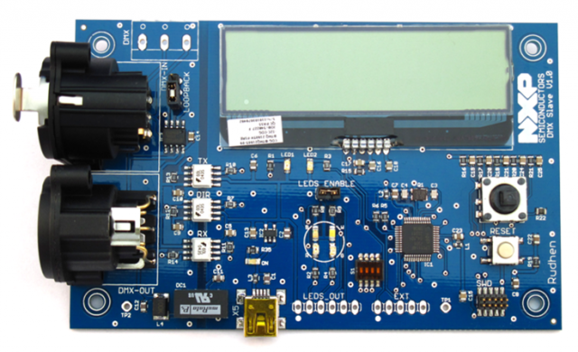

DMX512 Slave Board

Implementation example (DMX512 slave unit):
  • RDM-enabled DMX512 slave or receiver built around the NXP LPC111x Cortex-M0 microcontroller
  • Features four DMX controllable LEDs, a red heartbeat LED, a green traffic LED, DIP switches for selecting the DMX start address, a 5-position joystick, and an optional LCD
  • The UART and the 16-bit timer/counters of the LPC111x MCU are the main hardware blocks needed
  • The I2C hardware block is used to interface with the (optional) LCD functionality
  • References to DMX512 refer to DMX512-A, since both hardware and software are designed using the latest standard
Implementation example (DMX512 master unit):
  • DMX512 controller and monitoring device, built around the NXP LPC11U1x microcontroller, enabling Remote Device Management (RDM)
  • Features a USB interface, a red heartbeat LED, and a green traffic LED
  • The USB and UART of the LPC11U1x MCU are the main hardware blocks needed
