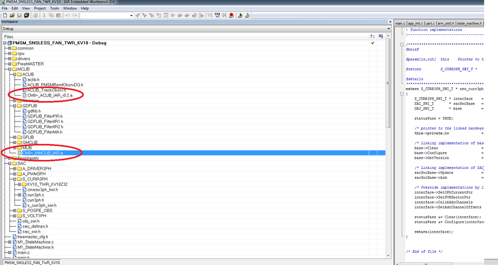

      I would like to know how to add KSDK platform library in a new IAR Workspace. I want to work on my own project with KSDK platform library.please help me on this.

I think you can add the *.a library to IAR project, this is the project for PMSM sensorless control.
Pls refer to the following fig.
Hope it can help you.
