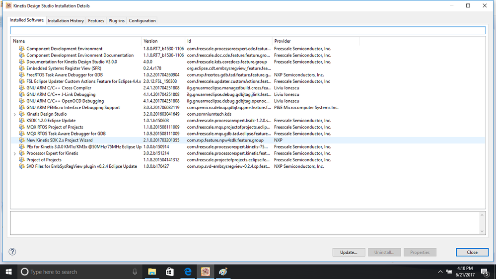

Hello, I am new to your development system. I am having a strange install problem. I have installed KDS version
3.2.0 and the following items are installed.

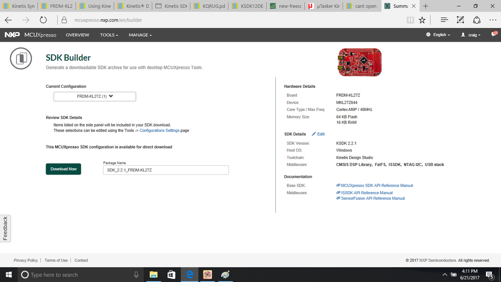

I have also installed SDK v2.2.1 for the FRDM-KL27Z. Attached is the configuration:

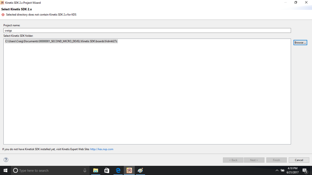

Finally, I CAN import the projects in the SDK but I cannot use the KDS to create a new project, I constantly get this
screen (with the error you see on the screen)
Can you help, I have installed and reinstalled and reinstalled again...No luck. Thank you. Craig

Hi Carig,
I don't know what happen. But I guess you may set a wrong directory when I look into your last picture. Please be sure to set the root directory of the unzip package. From the view of last picture, it should be "Kinetis SDK".
If I guess wrong, please let me know.
