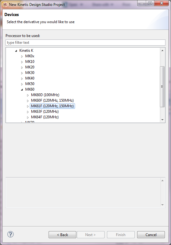

can we  create MQX project for TWR_K61 board using KDS_2.0.0 and KSDK_1.1.0 and MQX 4.1 ?
I couldn't find any k61 option in KDS .

Hello Joseph,
you can create your project with MQX 4.1. using KDS 2.0. but without KSDK.
the KSDK support for K60D10 series you can read from fsl_device_registers.h
#elif (defined(CPU_MK60DN256VLL10) || defined(CPU_MK60DX256VLL10) || defined(CPU_MK60DN512VLL10) || \
    defined(CPU_MK60DN256VLQ10) || defined(CPU_MK60DX256VLQ10) || defined(CPU_MK60DN512VLQ10) || \
    defined(CPU_MK60DN256VMC10) || defined(CPU_MK60DX256VMC10) || defined(CPU_MK60DN512VMC10) || \
    defined(CPU_MK60DN256VMD10) || defined(CPU_MK60DX256VMD10) || defined(CPU_MK60DN512VMD10))
You can see there is no support for your MCU.

ivadorazinova
Hello joseph,
You can create project only with MQX 4.1. because there is no support for KSDK.
There is no support for current KSDK 1.1.0. But we plan it in future.
For only MQX 4.1. is support for TWR-K60F120M.
In KDS you can work with Processors > MK60 > MK61F
Hope this helps,
Iva

Kan_Li
Hi Josephxavier,
I am sorry, but current KSDK hasn't support Kinetis 120MHz/150MHz parts yet, which would be supported in the future.
Have a great day!
