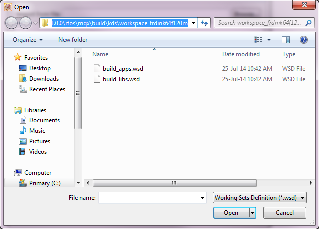

Yes. You can find it C:\Freescale\MQX_KSDK_1.0.0\rtos\mqx\build\kds\workspace_frdmk22f120m
There are two files build_apps.wsd and build_libs.wsd.

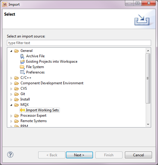

  2. click finish. After that, go to File -> Import -> MQX -> Import Working Sets mqx2.png
  4. Please choose build_apps.wsd, open -> Finish
  5. The same with build_libs.wsd, open -> Finish

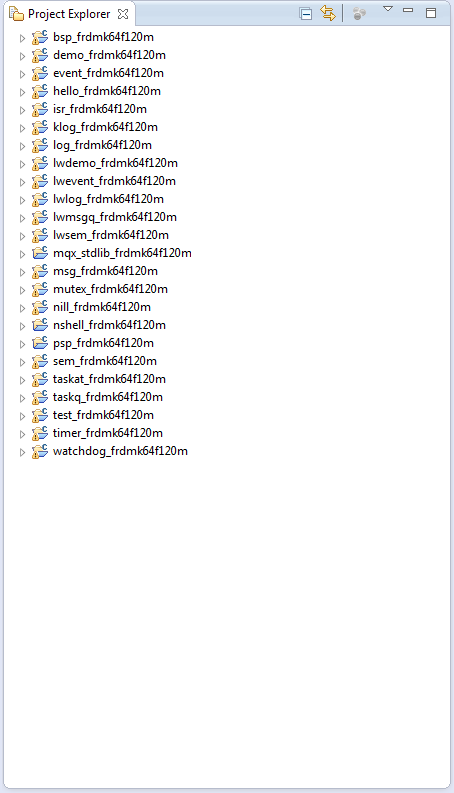

  6. Now you have files in Project Explorer, which you can edit.
