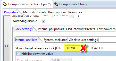

In addition to help provided by Mark, keep an eye to the internal oscillator frequency. There seems to be a bug not fixed in Processor Expert, which lists by default an Internal Oscillator clock of 32.768 kHz:

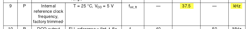

The correct trimmed value out of the factory should be 37.5 kHz as stated in the datasheet:
I hope this helps.
