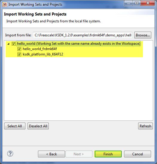

I have installed KDS in windows XP .And i have updated new version of KSDK into KDS IDE .But if i will import any demo project while building the project i am getting below error
make: *** No rule to make target `C:/Freescale/KDSK/examples/frdmk64f/demo_apps/hello_world/kds/../../../../../lib/ksdk_platform_lib/kds/K64F12/debug/libksdk_platform.a', needed by `hello_world_frdmk64f.elf'
Can you please give answer why I am getting these errors?

Hello vadrevu,

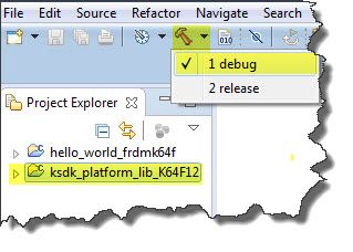

this error means that you should compile the library first to create the .elf file.
Always is needed to compile the libraries first and then the project.

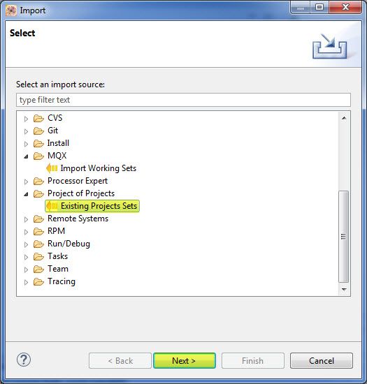

You can import your project with all needed libraries by this way:
  • File -> Import
  • Import Existing project sets under Project of Projects
  • select browse, for example C:\Freescale\KSDK_1.2.0\examples\frdmk64f\demo_apps\hello_world\kds and select the .wsd file

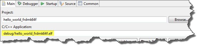

After this, debug the library first and then the project
The .elf file will be created under debug configurations
I hope this solved your issue.
