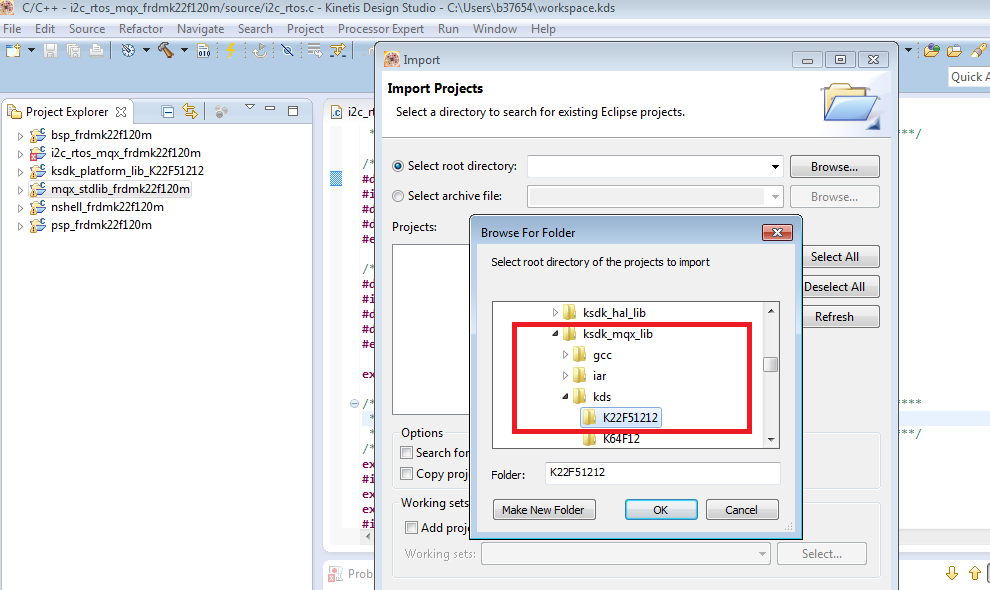

I am trying to build the I2C RTOS demo using MQX. I have imported:
  i2c_rtos_mqx_frdmk22f
  mqx_frdmk22f
  mqx_stdlib_frdmk22F
  nshell_frdmk22F
When I build all, everything goes OK except that I get:
make: *** No rule to make target `C:/Freescale/KSDK_1.1.0/demos/i2c_rtos/i2c_rtos_mqx/kds/frdmk22f/../../../../../lib/ksdk_mqx_lib/kds/K22F51212/Debug/libksdk_platform_mqx.a', needed by `i2c_rtos_mqx_frdmk22f.elf'.
I try to (re)build just the first thinking that it may have been built as one of the later ones, but get the same error.
What project am I missing?
2,064 Views
anthony_huereca
You also need the KSDK MQX Platform library. This is the library that brings in all the KSDK drivers/HAL, with some special defines in the project settings so that it also works with the rest of the MQX RTOS. You can find this library at /lib/ksdk_mqx_lib/kds/K22F51212/
-Anthony

soledad
Hi David,
You need to add the ksdk_mqx_lib and build this library,
Then you can build the demo without issues.
Sol

Since I'm new to this environment, I'm trying to learn more about the ins and outs, etc. After taking the step Anthony suggested, I was able to get it to work. But, in your list of projects, I see:
  bsp_frdmk2f
  ksdk_platform_lib_K22f51212
  psp_frdmk22f120m
Are these extraneous and not used at link time? Or, do they provide some advantage/feature that I'm not aware of?
2,064 Views
anthony_huereca
Hi David,
The BSP and PSP libraries are only found in "MQX for KSDK 1.0.0 Beta" release. They are no longer in the newer KSDK 1.1 release, so that's why you don't see them. The ksdk_platform_lib_K22F51212 is the non-MQX version of the KSDK platform library. Since you're using MQX, you need the MQX version of that platform library which I pointed you to in my original post.
  So you're not missing anything, you're all good to go.

davepfaltzgraff
Senior Contributor I
Hi Anthony,
Thanks for the pointer. I figured it was something simple like that but I felt as though I was trying to find a needle in the haystack.
I have now been able to run all the KSDK demos for the K22F that do not require two boards. For me that's a significant milestone.
Thanks!
