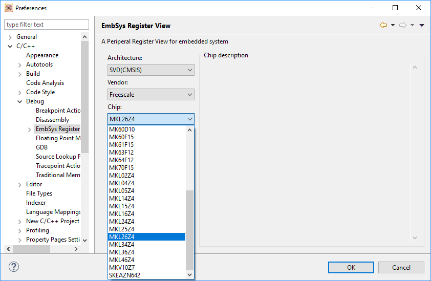

When trying to specify the chip I'm using so I can see the microcontroller's registers in the EmbSys view of KDS, I can't find MKL28Z in the list of chips to select from. Anyone know where it is? I'm using KDS v3.2.0. Is there a patch or update that I'm missing?

Yes, that is what I want mine to look like. But instead, it just looks like:
I think the reason I don't have it is because I can't find the right data (as described in my last post). The correct data is not on your sourceforge site (from what I can tell). I believe this is because your posts suggest I need to download the appropriate files from NXP (specifically, I need com.nxp.svd-embsysregview-0.2.4.sp_root_1.0.0.b170427). But I'm having difficulty getting the command line version of eclipse to run due to PATH variables not being able to run the java virtual machine from the console. I could keep working on this to download the appropriate data, but it would be extremely helpful if you had the appropriate file posted on sourceforge so I could just download it. Let me know if that is a possibility.

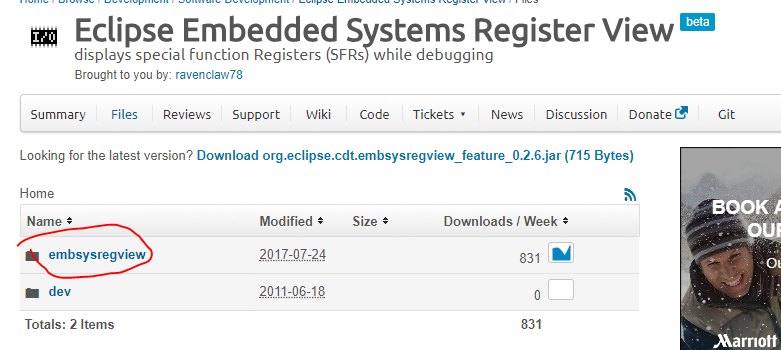

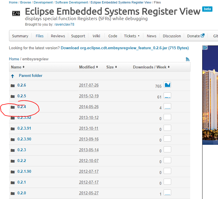

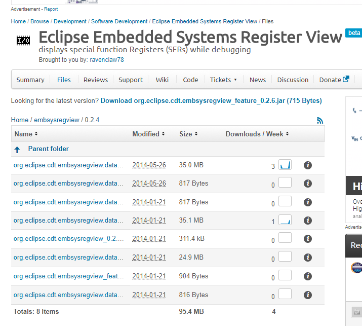

Thank you for the direct link. I was unable to find it through the links in your posts. I did finally navigate my way to the sourceforge site, and under files saw the following:
Of the items listed in 0.2.4, I didn't see the zip file you provided in the link above. Perhaps I didn't look in the right place?
In any case, thank you again for the direct link.
