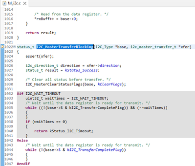

I am trying to exchange data via I2C with TI's IC in MKL03Z32CAF4, and I am using fsl_i2c.c driver to create the code.
I am in an infinite loop with I2C and cannot solve the problem.
First of all, I am trying to use the
 I2C_MasterGetDefaultConfig(&masterConfig);
 masterConfig.baudRate_Bps = 100000U;
 sourceClock = CLOCK_GetFreq(I2C0_CLK_SRC);//48000000;
 I2C_MasterInit(I2C0, &masterConfig, sourceClock);
After doing the following, I did the following code to do READ only.
 masterXfer.slaveAddress = I2C_MASTER_SLAVE_ADDR_7BIT;
 masterXfer.direction = kI2C_Read;
 masterXfer.subaddress = (uint32_t)reg_ad;
 masterXfer.subaddressSize = 1;
 masterXfer.data = rxBuff;
 masterXfer.dataSize = datasize - 1;
 masterXfer.flags = kI2C_TransferDefaultFlag;
 I2C_MasterTransferBlocking(I2C0, &masterXfer);
But I feel that I2C is not working properly because it enters an infinite loop in the while() of I2C_MasterTransferBlocking().
If anyone knows a solution, please let me know.
By the way, the following code has an infinite loop at while().
 /* Clear all status before transfer.
 I2C_MasterClearStatusFlags(base, kClearFlags);
 /* Wait until the data register is ready for transmit.
 while (! (base->S & kI2C_TransferCompleteFlag))//(base->S & (uint8_t)kI2C_BusBusyFlag)//
Translated with www.DeepL.com/Translator (free version)

First, check that you are using the latest SDK. My version (for another Kinetis) has a timeout implemented:
In any case, you can easily add such a timeout to your SDK code, I did that for other cases too.
The SDK code is not 'static': you are free to update it for your needs.

I have tried to time out the I2C, but it goes into "return" and the I2C stops. Also, I have a problem with the
"while (! (base->S & kI2C_TransferCompleteFlag))"
to
"while(base->S & (uint8_t)kI2C_BusBusyFlag)"
but base->S does not change anything from 0x20, so it enters an infinite loop.
