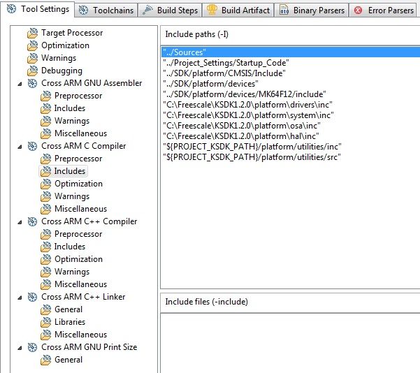

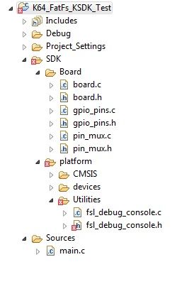

Here is my folder structure:
Here is my Include path inside Project -> Properties -> C/C++ Build -> Settings -> Cross ARM C Compiler -> Includes
What am I missing?

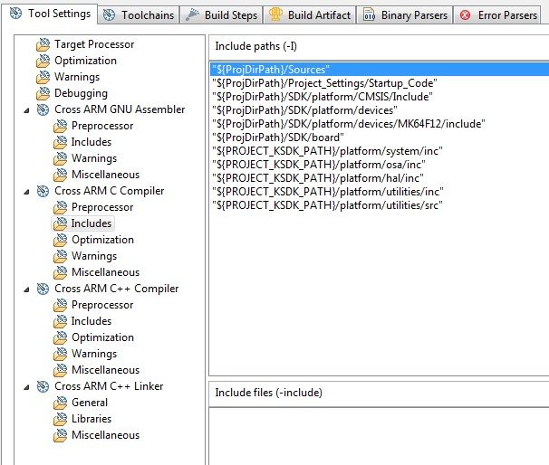

Update,
I fixed some of the include paths, now I have the following:
Here you can see that after compiling, I am still getting an X under board:
Here I am displaying Problems, notice where it says: make: ***[SDK/Board/board.o] Error 1..........why is it Board/board.o
Can someone pick up where the error is?

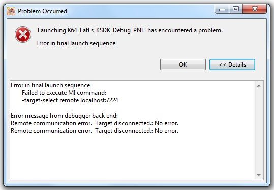

I decided to trash the whole thing and start fresh using FatsF + SDHC demo, but omitting i2c and accelerometer stuff.
I got it to compile successfully, but now I am trying to run it and its giving me the following problem.
I am connected to the OpenSDA port on the FRDM-K64F evaluation board and I am also connected
to the PE micro Multilink Universal on the JTAG connector.  I am not sure what's happening, why the
above is displaying, have someone seen this before?
By the way, I have to eval boards and both have the same behavior.
Neil
