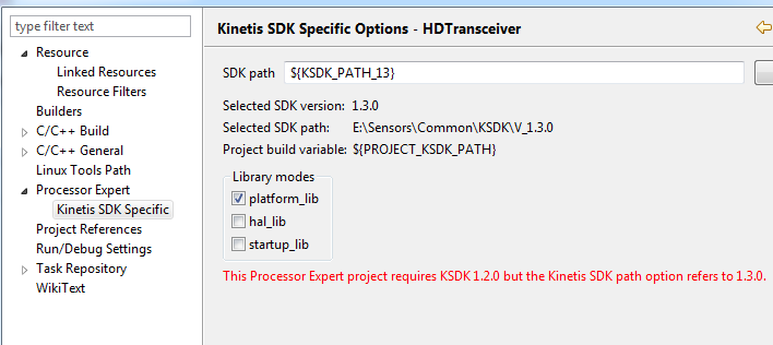

I have a large project that has been created with KDS 3.0 using Processor Expert and KSDK 1.2.0. I would like to upgrade to KSDK 1.3.0, so I have downloaded and installed KSDK 1.3.0 and I also installed the KSDK 1.3.0 eclipe update in KDS.
How do I upgrade my project in order to use KSDK 1.3.0? If I change the Processor Expert KSDK path in the project settings I just get an error message (see below).

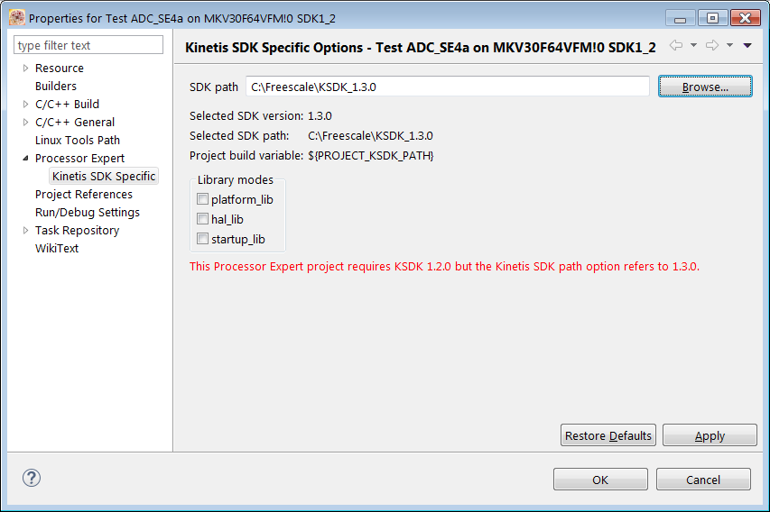

When you select the different version of the KSDK (e.g. KSDK 1.3.0), you can click on the OK button:

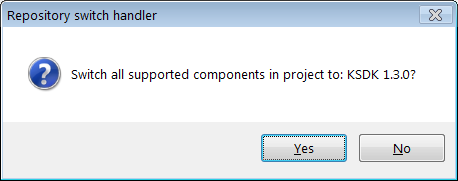

The Processor Expert offer to update the project to the new version of the KSDK, i.e. all components will be updated from the previous version to the new revision and all properties migrated. You must confirm the following dialog (click on the Yes button).
Your project will be updated.
Please note, that due to this updated it is strongly recommended review configuration of all components in the updated project. The new version of component can contain incompatible modification (e.g. a new property) and you must set the configuration (properties) accordingly.

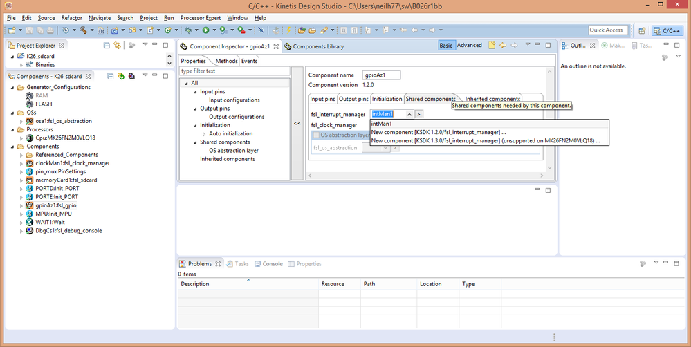

When I tried the upgrade I've ended up with a PORTE Error. Any suggestions?
With the initial KSD120 based project the events.c: PortE_IRQHandler was renamed to PORTD_IRQHandler which worked which is where I handle an SD_Card presence.
PortE0-5 has the SD card.

I've recovered to a previous version (export to archive file, then import current workspace from archive file)
On the fsl_xx its says  the following -

Hello Marek,
thank you for your answer. For some reason I did not see this dialog.

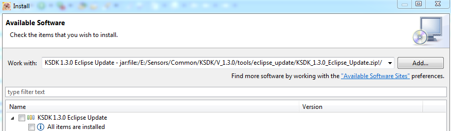

I'm using KDS 3 and KSDK 1.2 too, and want to update to KSDK 1.3 too.
You installed the KSDK using "check for update" option or "install new software" ?

Hello Carlos,
I downloaded and installed KSDK 1.3.0 from Freescale's website (Software Development Kit for Kinetis MCUs|Freescale) on my PC. Afterwards I installed the Eclipse Update for KSDK 1.3.0 that comes with the installation via "install new software":
